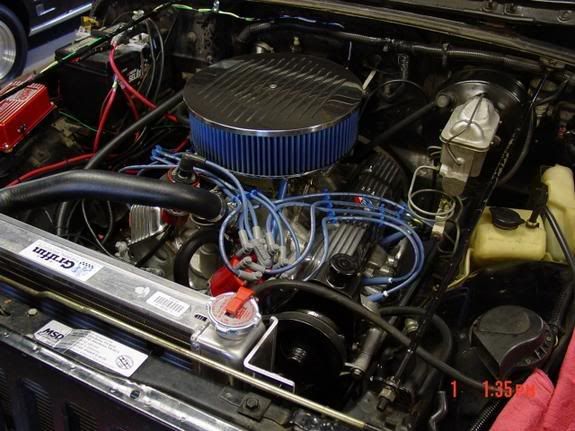

Updated running gear; rear D60, 35 spline, 4:88s, 37" tires, 6" RC SUA kit, 10.7" rear discs, .... Replacing front axle next.
Not sure how to attach pics. Will try the car domain website again.
http://www.cardomain.com/ride/358741/2
PS: Oh ya, new Bulltear 8 qt pan. Still holding 40 psi idle, hot oil pressure. Your midplate and remote filter also. Good stuff, thanks again.
PPS: Matt, those 2 rear bolts on the pan were a royal PITA to tighten, no room to sneak an extension through the gap with the trans cover or swivel socket with the AX15...any secrets? Did the 1/16th turn at a time trick w/ box wrench.
