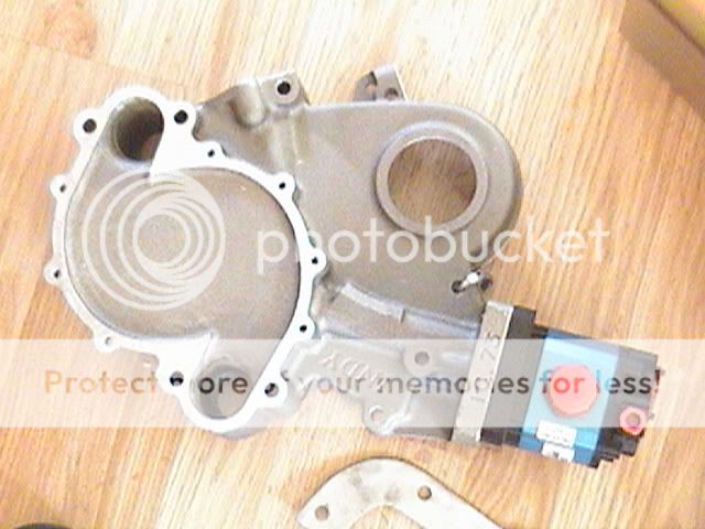

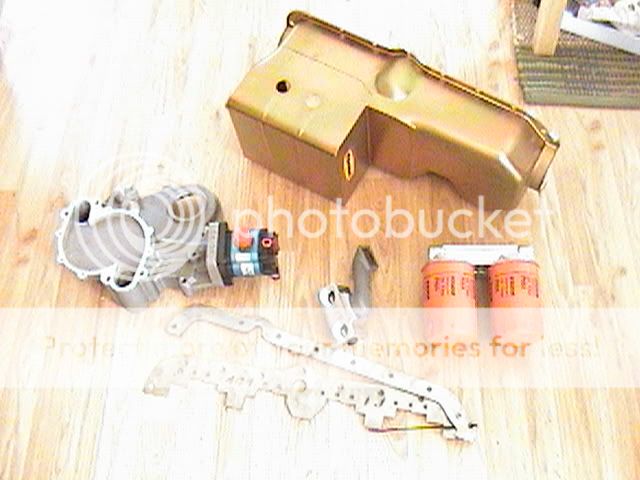

Finally got the pan and pump. The pump looks killer. I will finally get to use that dual remote filter I bought years and years ago.
This is a close-up of Indy's cover...

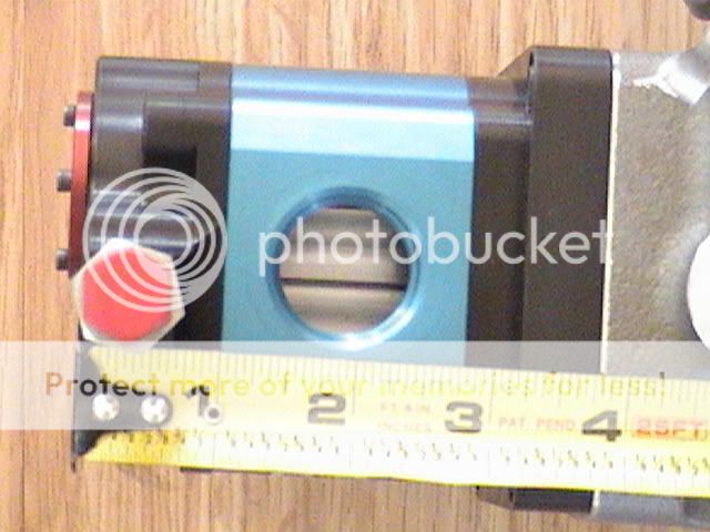

A view of the oil pump suction side...

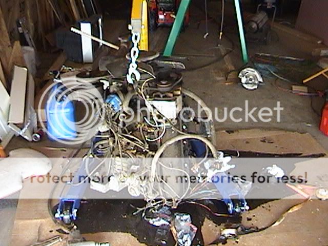

The start of my basket case 401 motor...
Talk about an oil leak!! Oops...thank good that wasn't the womans kitchen floor!! #-o

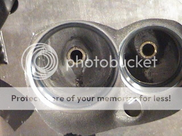

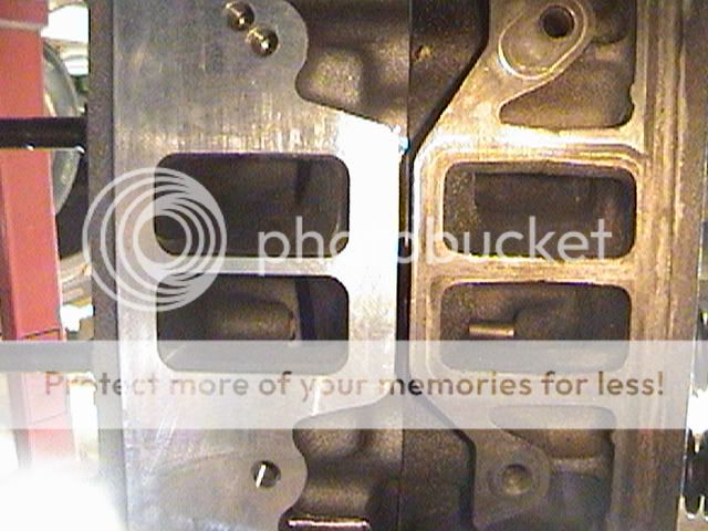

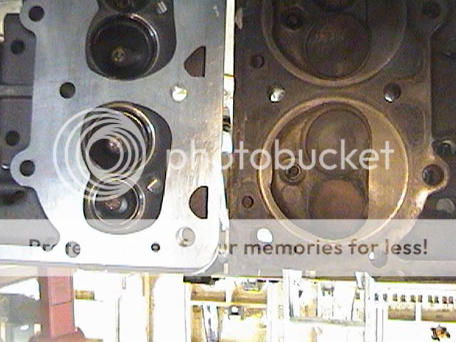

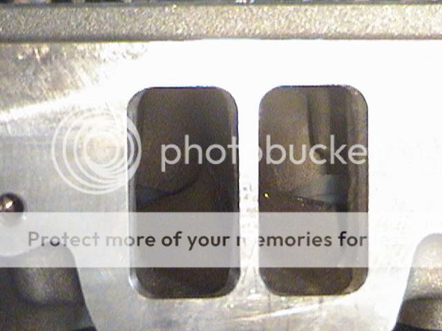

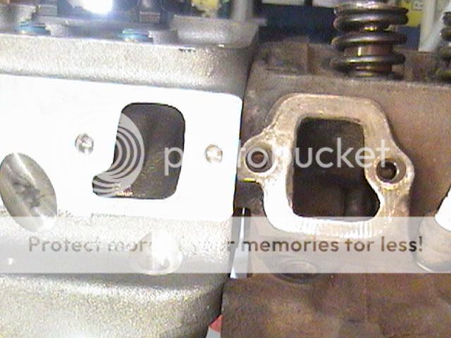

Indy heads Vs. stock heads
Of course the stock heads just didn't look good enough for me so...

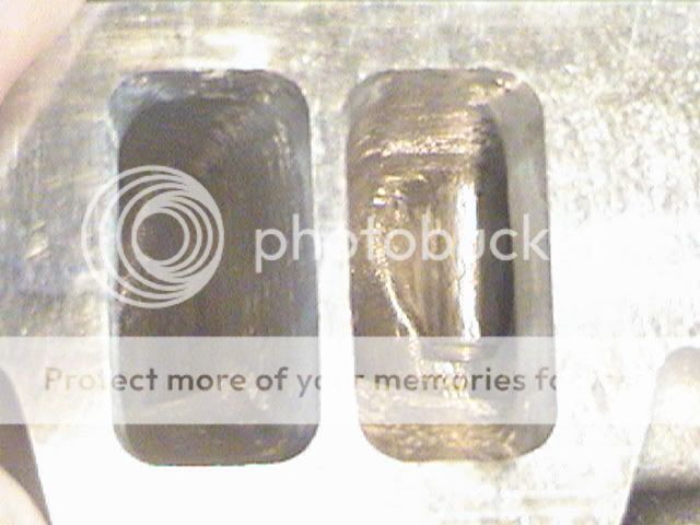

before
after
