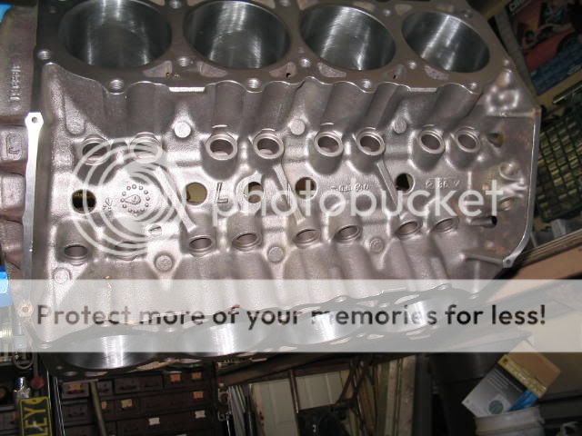

OK, It's finally making progress.
I've got the heads done - waiting my roller rockers
Had a hell of a time getting the dizzy gear off the cam, yeah, I broke it 🙁:
So I wound up taking it all out together!! :shock:
So I FINALLY got the crank out, and did the oil mod drilling the mains out to .339 (if this doesn't work MC, you owe me a block!!!) I stuck a bit in there to see the angle before just making that TiN bit chew up my block :shock:
Drilled the last 4 mains leaving the front timing chain one un-drilled
If you look close, you can see drillings where the bearings should be.
Now to get this all to the machine shop, have it acid dipped, crank ground and cross drilled, cylenders bored (probably .30), new pistons, cam, etc ... and get it put together.
