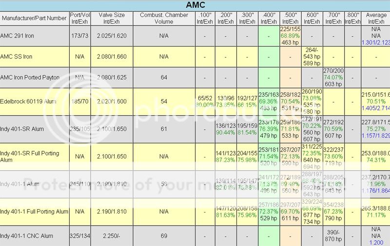

Stan Weiss wroteALL Volume numbers are in cc's. — ALL Flow numbers are in CFM.
* When calculating the average number, flow at .100 lift is not used. This will be line 1 in the average column and is in BLACK.
* When calculating the average exhaust / intake ratio there needs to be more than 2 flow numbers, and the number of intake and exhaust count must be equal. If present this will be line 2 in the average column and is GREEN.
* When calculating the CFM flow per cc of intake or exhaust port volume only the highest intake or exhaust flow number is used.
If present this will be line 3 in the average column and is BLUE.
* Bigger is not always better (The highest flow numbers and/or largest port volume). — Velocity is just as important.
* We want the best flow number's with the smallest port volume and the highest velocity.
* Remember to compare all flow numbers. — Low lift flow does help performance.
* Looking at flow numbers near or above max. valve lift is meaningless.
* For street engines airflow at 0.400 inch lift is a good place to evaluate flow.
* Check the exhaust / intake flow ratio. If present this will be the second line in the cell and is GREEN.
* We show a Maximum Horse Power number calculated using 3 different formulas .400, .500 and .600 use one from AFR as show in a number of magazines, .600 and .700 uses a comp type formula and .800, .900, and 1.000 uses almost a Pro Stock type. Because this number is program generated and uses 8 cylinders it will generate bad data if the engine is other than an 8 cylinder. Some engines have had an override added to make them come out correctly ex. Harley-Davidson.
* One reason exhaust numbers vary is if one person attached an Exhaust Tube/Pipe, if I have this information it will be line 3 in the valve size column. The increase from a pipe will vary from head to head but at higher lifts in normally in the 4 to 7 percent range.
* Other reasons numbers may vary is valve size, and Bore Fixture Size> — If I have the Bore Fixture Size it will be line 2 in the valve size column.
* For a supercharged, or nitrous you will need a higher intake exhaust ratio.
* Use these numbers only as a rough guide.
* Remember when doing a comparison to other tables check at what pressure differential were they flowed?
* There is a calculator on the main page to convert flow numbers from one pressure differential to another.
