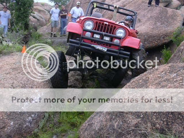

The shocks I have are Rancho 9112s I believe. They have over 12" of travel, and I use every bit of it. It will go over 1000 on a 23* ramp.
Look at the droop in this pic. Sorry it's a bit fuzzy.

eight
Ah, me put flex pic too
