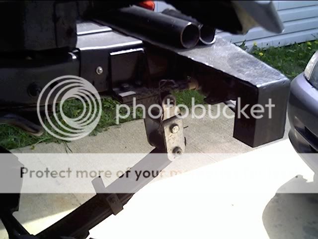

I ran a uncut, unturned scout dana 44 SOA on a cj5 for 4 years. Never had death wobble, never had tracking issues, steering wheel would come back to center every time. When I set it up I set it at 0 caster. No problems no issues.
The only thing you will run into is your pinon will be pointed in the dirt. (well not in the dirt but you will possibly have binding issues on thedrive line) Again I clearnance the yoke a bit.
You will have to grind a perch in the housing, Not a big thing.
To run it on a CJ-5 frame you will have to outboard the springs, Again not a big thing.
My current setup is (rounding hte numbers here folks)
60 inch dana 44 scout front end. Scout inners, chevy outters with chevy knuckles and highsteer.
60 inch dana 44 wagoneer rear
4 wheel disc, 4.56, Dana 300, sm420
36 SX on MRT beadlocks
Outboarded springs in the front
JC whitney CJ-7 rear springs on the front, Modified Wrangler springs in the rear.
and a bunch of other stuff.
So yes you can spend the cash on a chevy narrowed front or you can just use what you have and go for it.
Sorry I dont feel like resizing the images.
