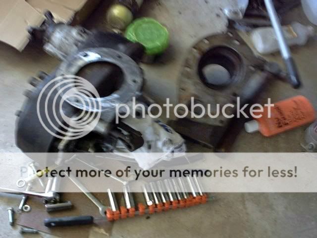

The dodge 435 has the right output shaft size and spline count, and also the right indexing hole in the adapter for the 300. But the shaft was about 3/4" too long so I cut that off. After the splines, the shaft necks up bigger, and the d300 input was now bottoming on it, which necessitated a 3/16" spacer. The bolt pattern in the adapter was wrong so I had to redrill it, that cast steel drills real easy. Then it bolted up, plenty easy enough.

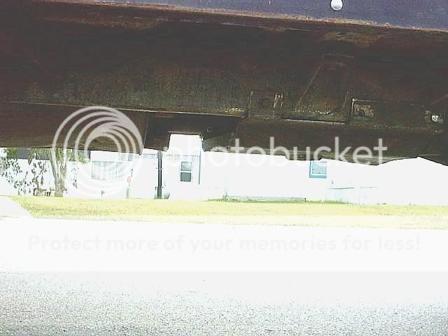

Skid plate is made of 3/16" plate steel. I used a big ugly metal bending machine to put the 2" drop in it. Then I set it up in place and noticed that the transmission hung lower than the mount, so the skidplate hit it before the mount. A little persuasion from a 12 lb hammer got it to clear. There are 3, 1" bars run across it on the inside for support. Two just before and after the transmission mount, and one more at the back. I have also eliminated the torque arm. Skid plate bolts on from the side with 6, 3/8" bolts. I jacked the jeep up about a foot under the skid plate, and it did not bow. That little thing in the middle is a peice of 3/8" plate, it has two big holes in it for the trans mount bolt heads, and is there just to protect them.

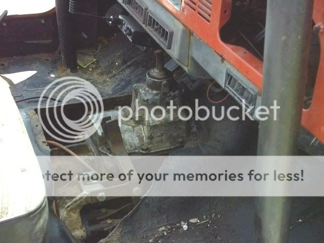

Had to do some cutting on the floor to make the clocked 300 fit. Didn't have to cut this big.
