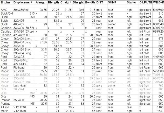

Engine Displacement Alength Blength Cheight Dheight Ewidth DIST SUMPSTARTER OILFILTER WEIGHT
AMC 304/360/401 28.75 29.25 21.25 29.50 21.50 front rear right right front 540/600
Buick/Olds 215 x 28.00 x 27.00 26.00 front rear x right front 315
Buick 350 29.00 30.50 21.50 28.50 23.00 front rear right right front 450
Buick 322/425 x 33.50 x 29.00 28.00 rear rear left right rear 685
Buick 400/455 29.00 30.00 22.00 30.00 23.00 front center right right front 600/640
Cadillac 331/390 60-62 x x x x x rear rear left right rear 699/720
Cadillac 331/390 63-up x x x x x rear rear left left front 699/720
Cadillac 425/472/500 30.00 30.50 28.50 32.00 28.50 front rear right left front 625
Chevy 262/400 Short WP 26.50 27.00 20.50 27.00 22.00 rear rear right left rear 575
Chevy 262/400 Long WP 27.88 28.38 20.50 27.00 22.00 rear rear right left rear 575
Chevy 348/409 x 34.50 x 32.00 28.50 rear rear right left rear 685
Chevy 396/454 Short WP 30.50 30.50 23.50 33.00 27.00 rear rear right left rear 685
Chevy 396/454 Long WP 32.00 32.00 23.50 33.00 27.00 rear rear right left rear 685
Ford 221/302 27.00 29.00 22.00 27.00 22.00 front front right left front 440/460
Ford 332/428FE 30.00 32.00 28.00 32.00 27.00 front front right left front 650
Ford 427 SOHC 32.00 34.00 30.00 34.00 32.00 front front right left front 680
Ford Flathead 30.00 30.00 22.00 x 26.00 front front left left rear 569
Mopar 273/360 29.50 29.50 23.50 31.00 25.00 rear front left right rear 525/560
Mopar V10 488/505 36.88 36.88 23.50 x 25.00 x front left right rear 716/816
Mopar 350/440 29.00 30.00 24.00 30.50 29.50 front center left left front 620/670
Mopar 331/392 Hemi 32.00 31.00 24.00 31.00 29.00 rear center left right rear 729/745
Mopar Late Hemi 32.00 32.00 24.00 32.00 29.00 front center left left front 765
Olds 303/394 x 32.00 x 29.00 30.00 rear rear right right rear 700
Olds 350 28.25 28.25 20.25 27.50 26.00 rear rear left right rear 560
Olds 455 29.00 31.00 24.00 31.00 26.50 rear rear left right rear 605
Pontiac 350/400 28.25 29.00 20.00 31.00 27.00 rear rear left right rear 650
Pontiac 455 29.50 32.00 27.00 33.00 27.00 rear rear left right rear 650
Allison V12 1710 x 44.00 36.00 x 30.00 rear rear rear x 1160
Merlin V12 1649 x 71.00 29.80 x 43.00 rear rear right x 1540

[img]http://img.photobucket.com/albums/v442/pyagid/weight.jpg[/img]
oh showing me up huh.......dang that looks good Paul!!
8)

How about a link to that there spreadsheet, bub?
Holeshot
You could add a column for BoreStrokeRatio (BSR) & one for RodStrokeRatio (RSR), those numbers REALLY tell the tale
