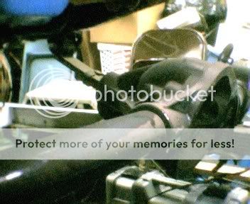

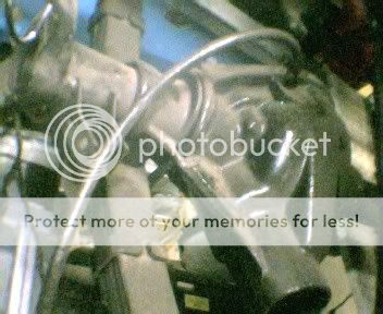

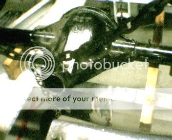

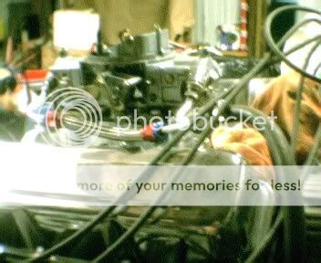

rollbar Thanks, here's a shot of the axle w/a 20 dollar camera from wal-mart. Here's thr rear: Here's the holly:
Trailbst Spend the $150. Otherwise, you'll have to put a plate over it, and then spend a bunch of money to have the axle machined to accept an inner bearing, and axle shaft. Erik
