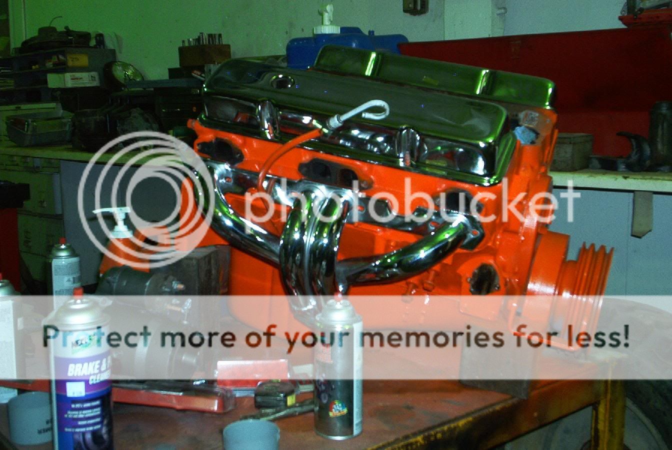

junkyard jim Just thought I'd mention that this is a 700R4 and not a TH400! (can't tell if it's the 4L60 or 4L80E yet) durbs wroteok this one will work 🙂 Rebuilt TH400
